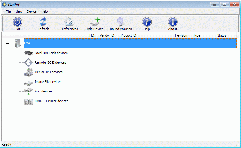

Launch the StarPort control application by selecting Start->All Programs->StarWind Software->StarPort->StarPort. After the program is started its icon appears in the system tray. Double click the icon with the left mouse button or single click it with the right mouse button and select Start Management item from the pop-up menu. You'll see a picture like the one below:
01
Select Add Device menu item from Device drop down menu or just press Add Device button on the application tray bar. New device installation wizard (see next page for the image) will appear.

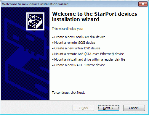

On the first step of the New Device Installation Wizard please read the introduction instructions.
02
Press Next button to continue.

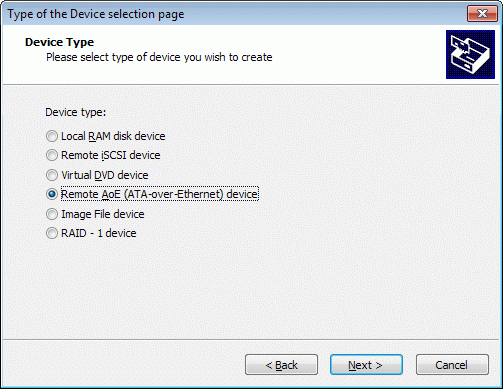

On the second step of the New Device Installation Wizard select device type you wish to install. To add an AoE device please select Remote AoE (ATA-over-Ethernet) device.
03

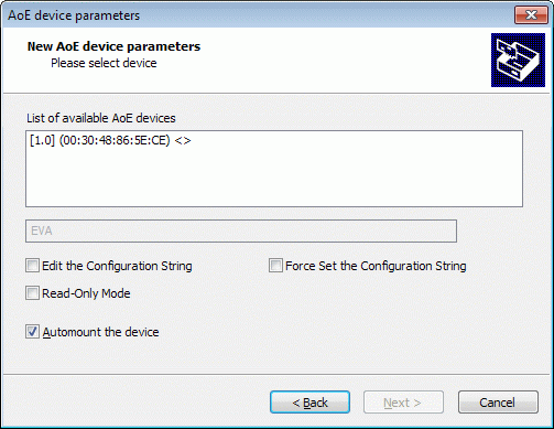

On the fourth step of the New Device Installation Wizard please specify the parameters of the AoE device you wish to add (see next page for the image):
Select device you wish to add from the list of the available AoE devices.
If Edit the Configuration String option is selected you can specify custom AoE configuration string. By default StarPort uses exact PC name as the configuration string. You should change the configuration string only if particular AoE device could not be mounted successfully and you are sure specified default configuration string is wrong.
Select Force Set the Configuration String option to overwrite the configuration string of the AoE device. In this case device's existing configuration string is changed and device is mounted with a new configuration string.
Select Automount the device to automatically re-create it when you restart your PC. It means an AoE device becomes available right after your PC boots and Windows starts.
Select Read-Only Mode if you wish to enable read-only access to the AoE device that you mount.

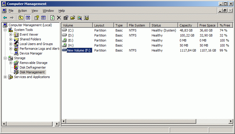

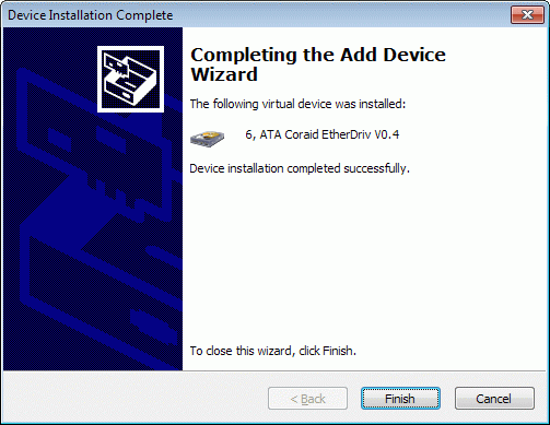

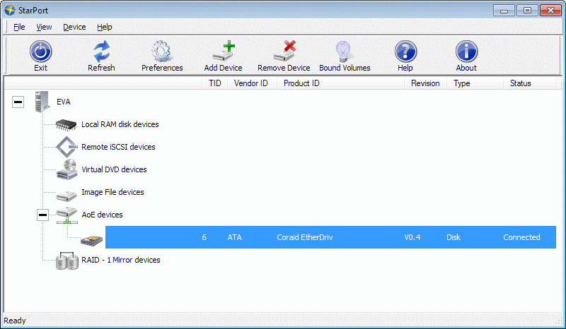

On the last step of the New Device Installation Wizard please confirm the installation results. If the new AoE device was installed correctly, it should appear as a new disk volume in your system. Right after that you will be able to access installed AoE device as an ordinary disk volume.
06
Press Finish button.
07 08

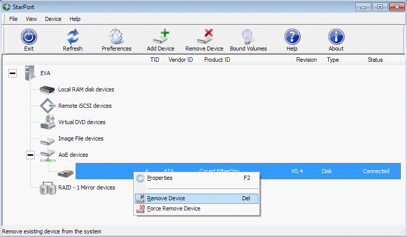

Removing existing device
In the StarPort control application please select the device you wish to remove and click it with the right mouse button.
09
Select Remove Device menu item from the pop-up menu that appears.
Use the Force Remove Device if you cannot remove a device in a normal way (e.g. it is locked by some application or process). However it is not recommended to use the Force Remove Device feature as it may cause loss of the data and general system instability.
Alternatively you can remove a device by doing the following: right click StarPort icon in the system tray and find the device you wish to remove.
10
