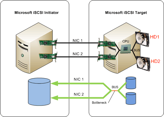

Standard way:
The standard way of implementing an iSCSI SAN on a separate dedicated box would cause the following issues:
  1. DAS limitations. The maximum amount of jacks for IDE/SCSI/SATA devices on the Motherboard is limited. Moreover, the connection interfaces length is also limited: Parallel ATA only allows cable lengths up to 18 inch (460 mm); SCSI SSA - 984 inch (25 m). Also, there is a limitation in the amount of devices that one can connect to a single interface port.
  2. CPU limitations. No matter how many storage arrays or disks there are on the iSCSI Target PC - the amount of CPU remains the same.
  3. BUS limitations. One cannot extend the transfer rate of an existing BUS. No matter how many network interfaces there are in an iSCSI network.
The standard way
