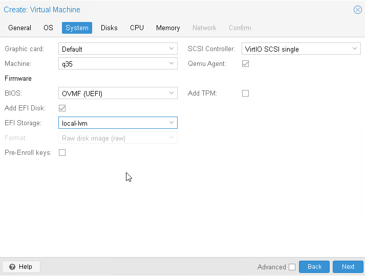

6. Specify system options. Choose Machine type q35 and check the Qemu Agent box. Click Next.

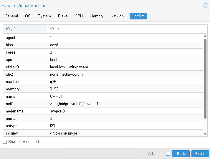

11. Confirm settings. Click Finish.

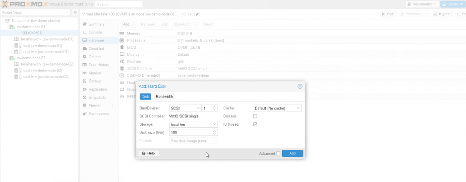

1. Open the VM Hardware page in Proxmox and add a drive to the VM, which will be used by the StarWind service. Specify size of the Virtual disk and click OK.
Note. It is recommended to use the VirtIO SCSI single controller for better performance. If multiple virtual disks are needed to be used in a software RAID inside the CVM, the VirtIO SCSI controller should be used.
2. Repeat step 1 to attach additional Virtual Disks.
3. Start the VM.
4. Repeat steps 1-2 on all nodes.

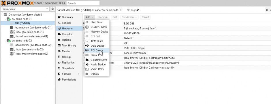

Attaching PCIe device to StarWind Virtual SAN CVM
1. Shut down the StarWind VSAN CVM.
2. Open the VM Hardware page in Proxmox and click Add -> PCI Device.3. Choose PCIe Device from the drop-down list. 08_1_Add_PCIe_device
4. Click Add.08_2_Add_PCIe_device
5. Edit Memory. Uncheck Ballooning Device. Click OK.08_3_Add_PCIe_device
6. Start VM.
7. Repeat steps 1-6 on all nodes.

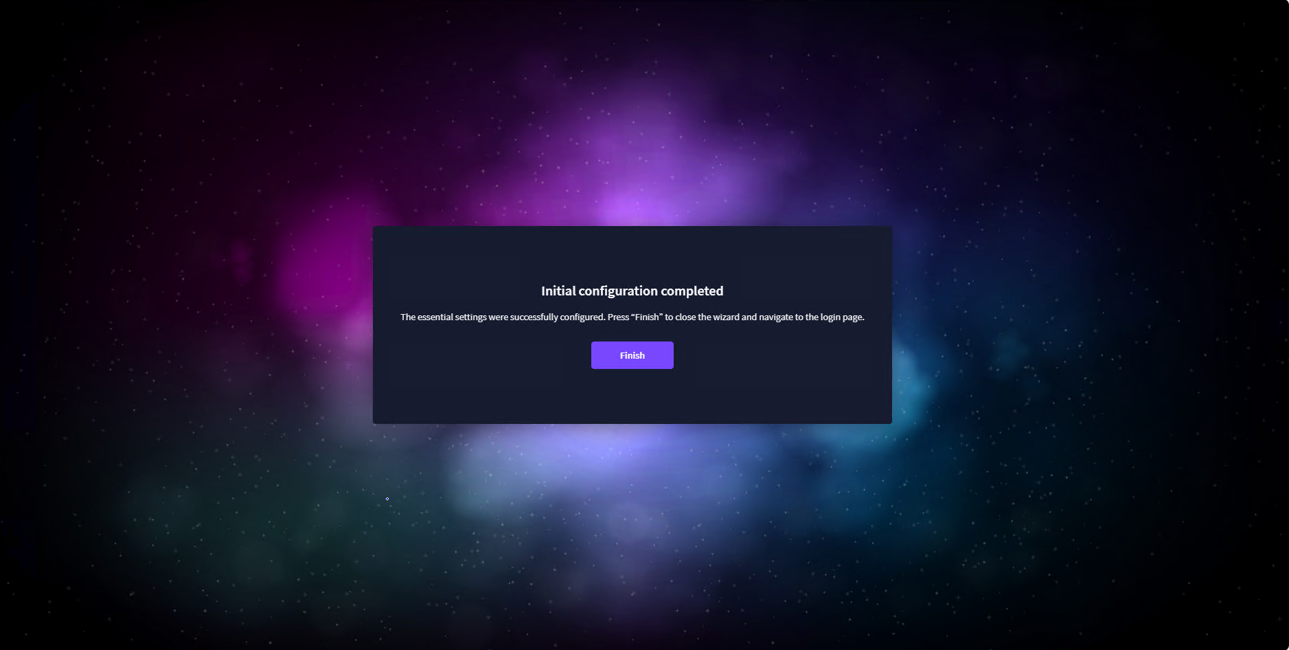

10. Wait until the Initial Configuration Wizard configures StarWind Virtual SAN for you.
11. Please stand by until the Initial Configuration Wizard configures StarWind VSAN for you.
12. Repeat steps 1 through 12 on each Proxmox host.
