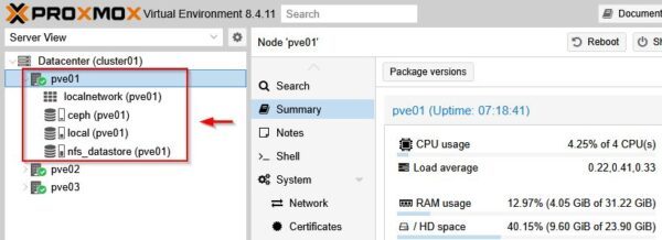

Ensure that all VMs and containers have been migrated off the node.

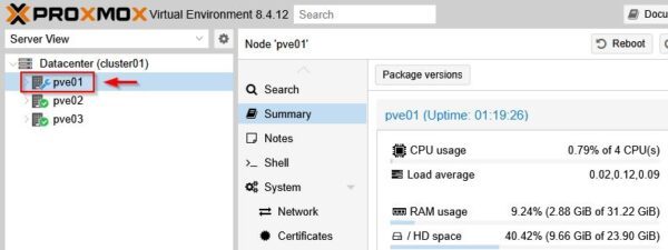

Place the node in Maintenance Mode to stop HA services.
# ha-manager crm-command node-maintenance enable pve01
wp-image-32597
The node is in Maintenance Mode.

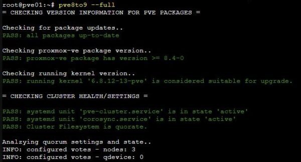

Before you begin the upgrade, run the check script to identify any potential issues and ensure your system is compatible with version 9.
# pve8to9 --full
A screenshot of a computer program AI-generated content may be incorrect.
If any issues are found, fix them before proceeding with the upgrade.

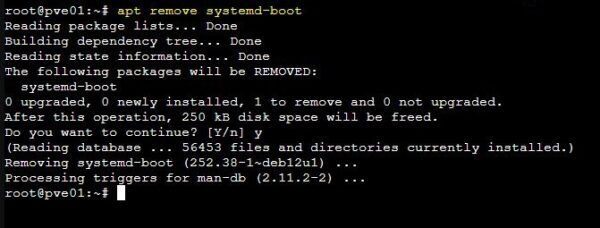

In this example, the system suggests removing the systemd-boot package.
wp-image-32605
Remove the package, but perform this operation carefully.
# apt remove systemd-boot

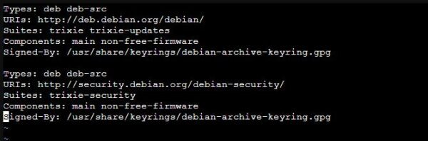

Create the file /etc/apt/sources.list.d/debian.sources and add the following lines to support the new version Trixie.
# vi /etc/apt/sources.list.d/debian.sources
Types: deb deb-src
URIs: http://deb.debian.org/debian/
Suites: trixie trixie-updates
Components: main non-free-firmware
Signed-By: /usr/share/keyrings/debian-archive-keyring.gpg
Types: deb deb-src
URIs: http://security.debian.org/debian-security/
Suites: trixie-security
A computer screen with white text AI-generated content may be incorrect.

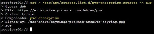

Add the Proxmox VE 9 repository
Create the related pve-enterprise.sources file.
# cat > /etc/apt/sources.list.d/pve-enterprise.sources << EOF
> Types: deb
> URIs: https://enterprise.proxmox.com/debian/pve
> Suites: trixie
> Components: pve-enterprise
> Signed-By: /usr/share/keyrings/proxmox-archive-keyring.gpg
> EOF
Remove the old /etc/apt/sources.list.d/pve-enterprise.list.
# rm /etc/apt/sources.list.d/pve-enterprise.list

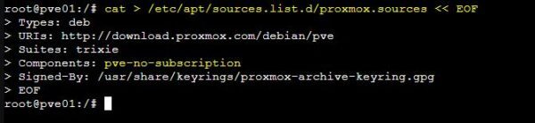

If you are using the no-subscription repository instead, run this command:
# cat > /etc/apt/sources.list.d/proxmox.sources << EOF
> Types: deb
> URIs: http://download.proxmox.com/debian/pve
> Suites: trixie
> Components: pve-no-subscription
> EOF

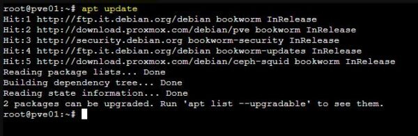

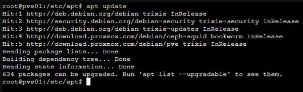

Verify that the apt update command gets the correct updates.
# apt update

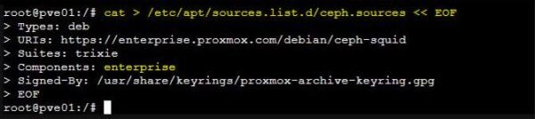

Enterprise repository
# cat > /etc/apt/sources.list.d/ceph.sources << EOF
> Types: deb
> URIs: https://enterprise.proxmox.com/debian/ceph-squid
> Suites: trixie
> Components: enterprise
> EOF

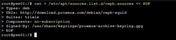

No-subscription repository
> Types: deb
> URIs: http://download.proxmox.com/debian/ceph-squid
> Suites: trixie
> Components: no-subscription
> EOF

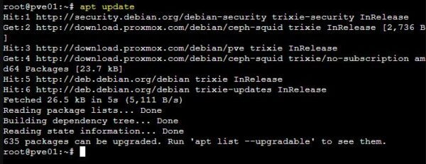

When the repository entries have been updated, refresh the repositories package.
# apt update

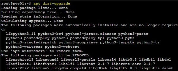

Upgrade the node.
# apt dist-upgrade
A computer screen shot of white text AI-generated content may be incorrect.

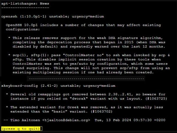

When the apt-listchanges: News page is displayed, scroll till the end and press q to quit.
A screenshot of a computer error AI-generated content may be incorrect.

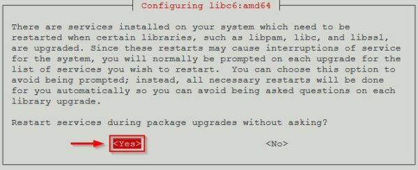

During the Proxmox VE 8 to 9 upgrade, you will be prompted to confirm file changes.
  • /etc/issue – choose No (keep the currently installed version).
wp-image-32620
  • Click Yes to restart services automatically.

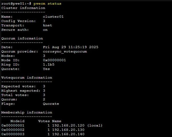

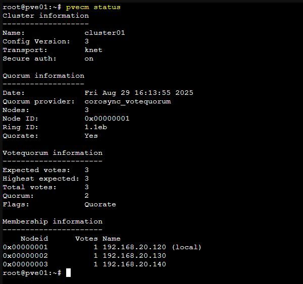

Check the Proxmox cluster status.
# pvecm status

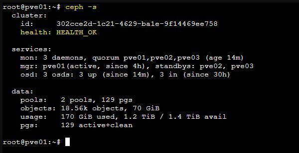

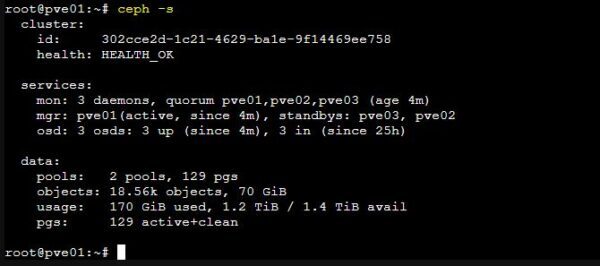

If you are using Ceph in your Proxmox infrastructure, verify the Ceph cluster is in a healthy state.
# ceph -s

Check again the Proxmox cluster status.
# pvecm status

Check if the Ceph cluster is in a healthy state.
# ceph -s
