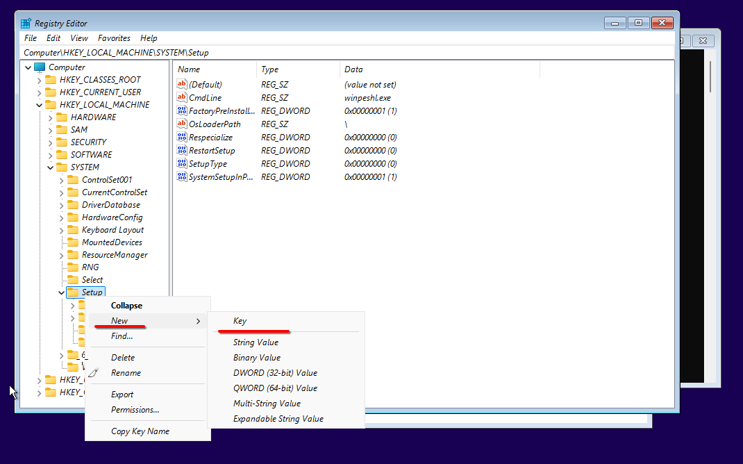

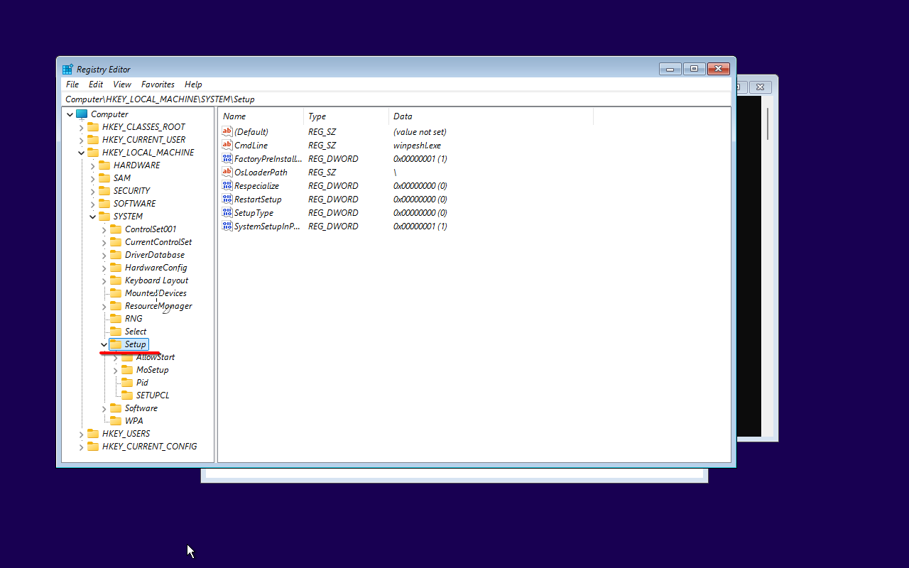

Step 5: Create the LabConfig key
1. Navigate to HKEY_LOCAL_MACHINE\SYSTEM\Setup.
Creating the LabConfig registry key
Figure 4: Creating the LabConfig registry key

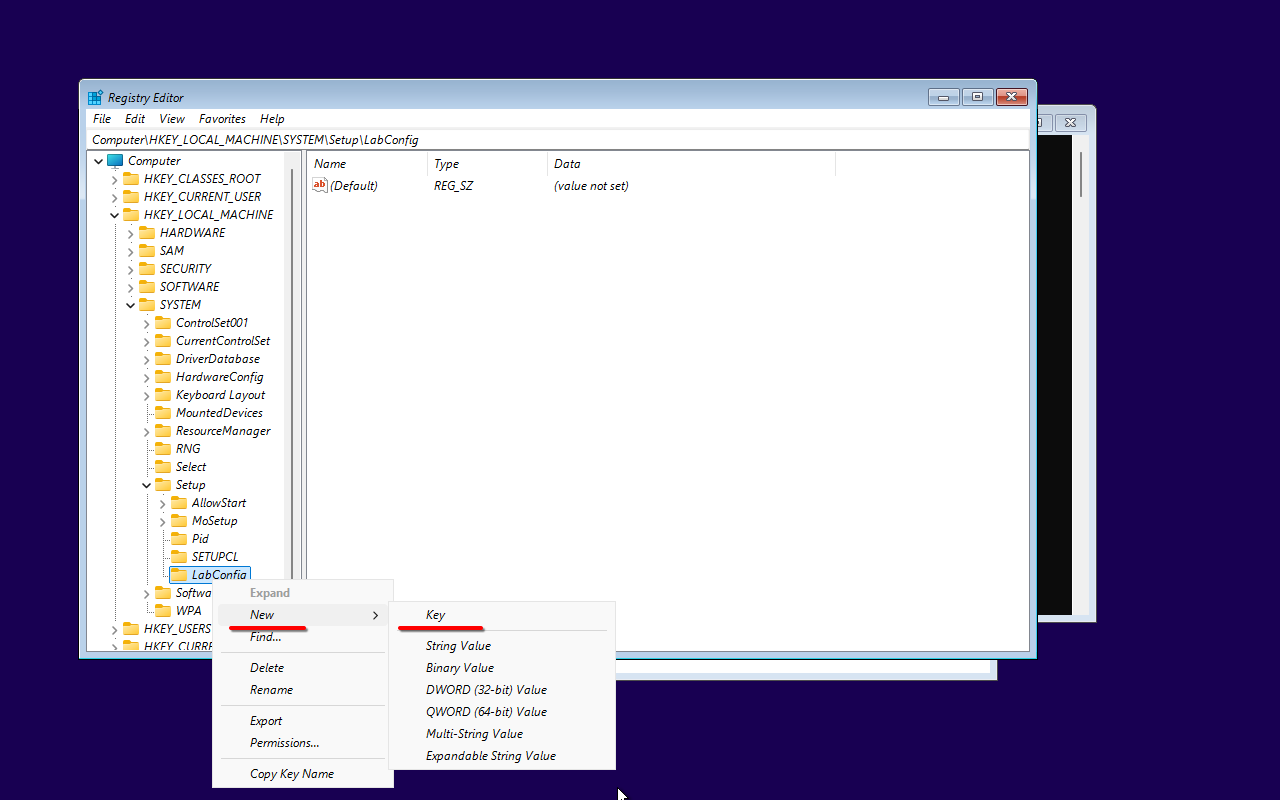

2. Right-click on Setup, select New > Key
Figure 5: Creating the LabConfig registry key

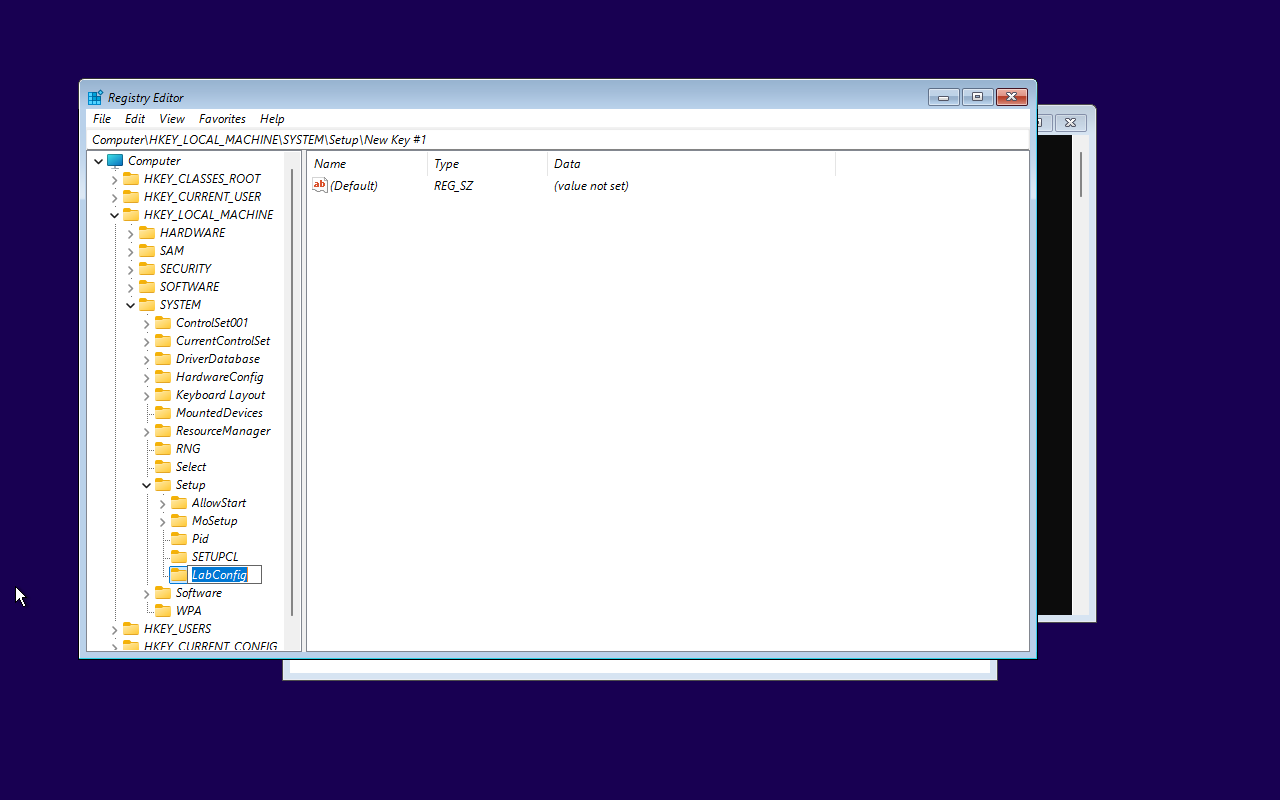

3. Name the new key: LabConfig.
Figure 6: Creating the LabConfig registry key

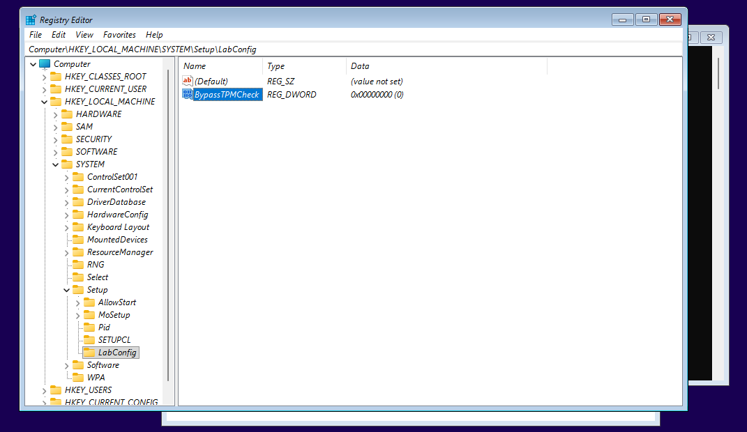

2. Name this new DWORD Value: BypassTPMCheck.
BypassTPMCheck value created
Figure 8: BypassTPMCheck value created
3. Right click the newly created value, click ‘Modify’, set the value to 1 and press OK.
BypassTPMCheck value set to 1
Figure 9: BypassTPMCheck value set to 1

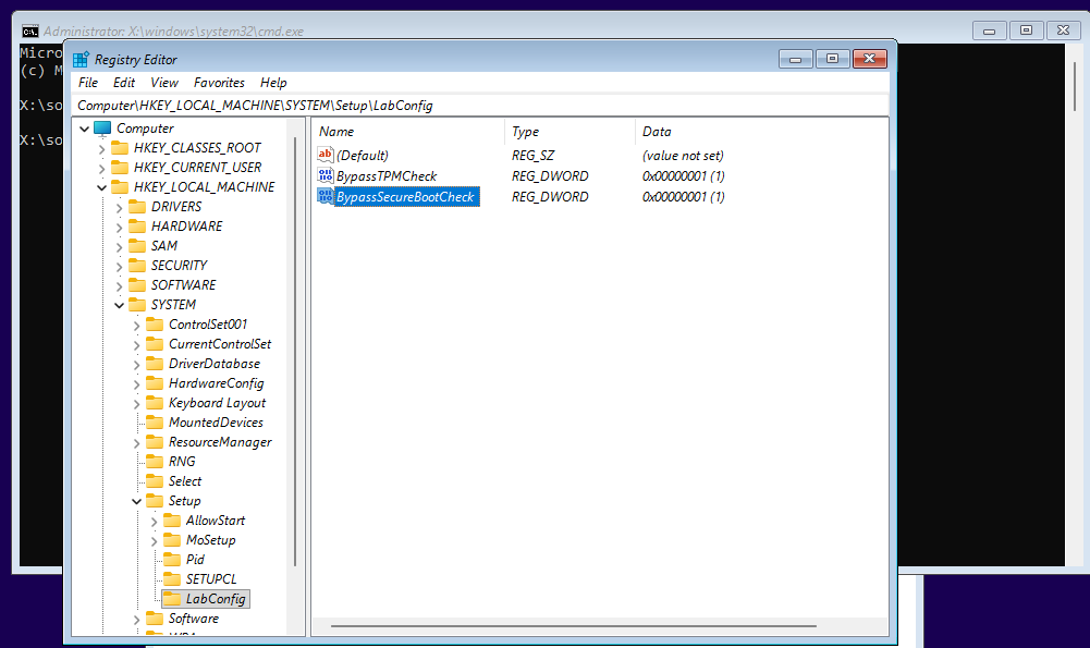

4. Create another DWORD (32-bit) value named BypassSecureBootCheck and set it to 1.
BypassSecureBootCheck value set to 1
Figure 10: BypassSecureBootCheck value set to 1

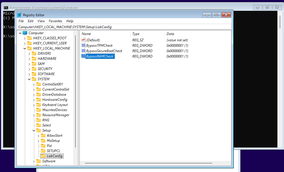

5. To bypass the RAM check, create a DWORD named BypassRAMCheck and set it to 1.
BypassRAMCheck value set to 1
Figure 11: BypassRAMCheck value set to 1
