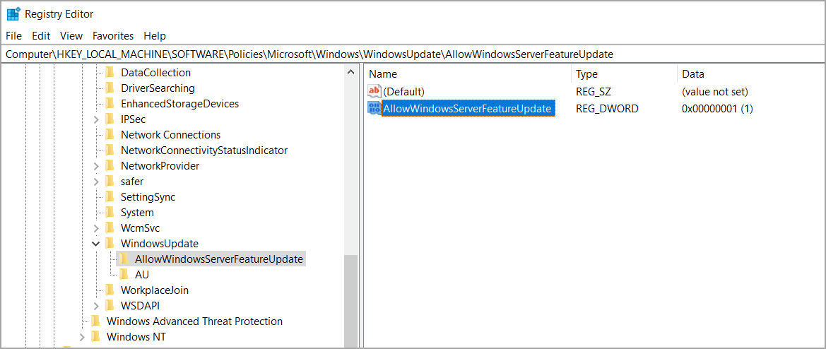

Yes, you must manually change a registry key in order for the upgrade process to trigger. If you don’t do that, the in-place upgrade will never happen. You can use PowerShell and one line of code (use elevated PowerShell prompt) to trigger the in-place upgrade.
Well, in fact, 2 commands:
New-Item -Path "HKLM:\SOFTWARE\Policies\Microsoft\Windows\WindowsUpdate\AllowWindowsServerFeatureUpdate"
New-ItemProperty -Path "HKLM:\SOFTWARE\Policies\Microsoft\Windows\WindowsUpdate\AllowWindowsServerFeatureUpdate" -Name "AllowWindowsServerFeatureUpdate" -PropertyType DWord -Value 1
Those two commands create the registry entries automatically.
You can also do it manually, by opening regedit.exe and going to
HKLM\SOFTWARE\Policies\Microsoft\Windows\WindowsUpdate\AllowWindowsServerFeatureUpdate
Create a DWORD value named AllowWindowsServerFeatureUpdate and set it to 1.
Both do the same.
You can also manually create the reg entry

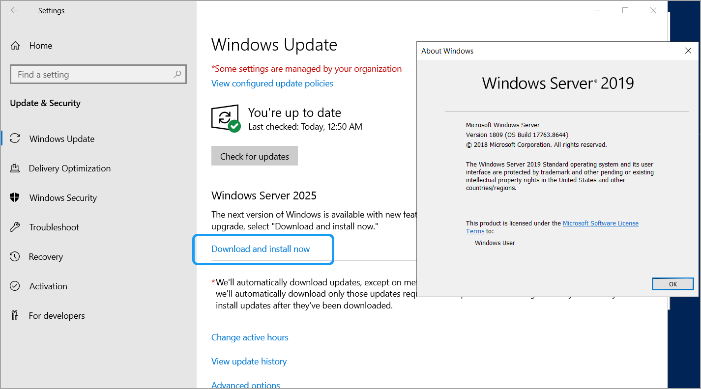

Desktop Experience (Full GUI):

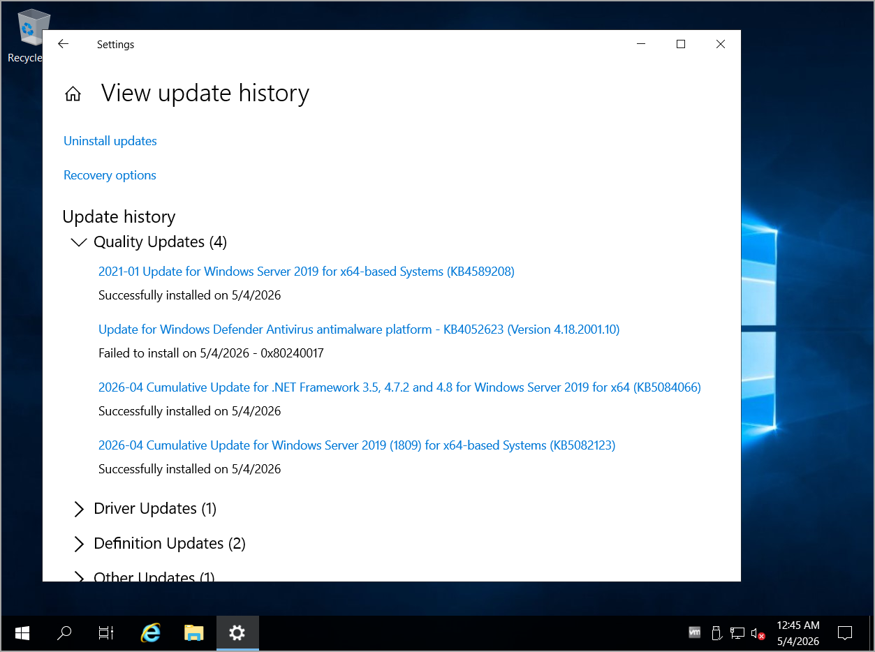

  1. Ensure the server is fully patched via Windows Update.
  2. Go to Settings > Windows Update.
  3. The Windows Server 2025 feature update should appear (after opt-in if required).
  4. Download and install — it will handle the in-place upgrade.
  5. Reboot when prompted. The process includes compatibility checks and preserves settings/apps.
A new option will allow you to go and upgrade to WS 2025 within Windows Update
This is straightforward for admins who prefer the graphical interface. Server Manager, MMC tools, etc., remain available post-upgrade.

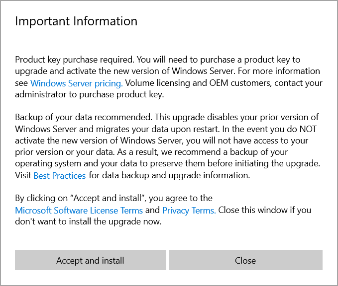

You’ll get a warning that you must purchase the product to upgrade and activate it.
Product key purchase acceptation screen

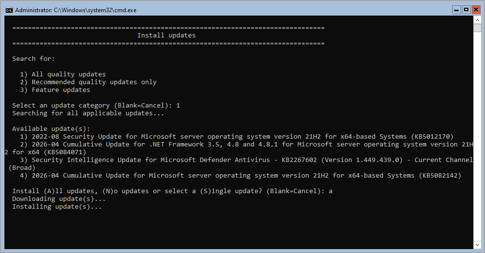

Server Core: Server Core benefits equally well from this method. Use SConfig (the text-based configuration tool):
  • Install the latest updates with Option 6 for Windows Update.
Install updates via SCONFIG
  • Add Registry Key: Open an elevated PowerShell prompt and run the following command to create the necessary registry entry:
New-Item -Path "HKLM:\SOFTWARE\Policies\Microsoft\Windows\WindowsUpdate\AllowWindowsServerFeatureUpdate" -Force

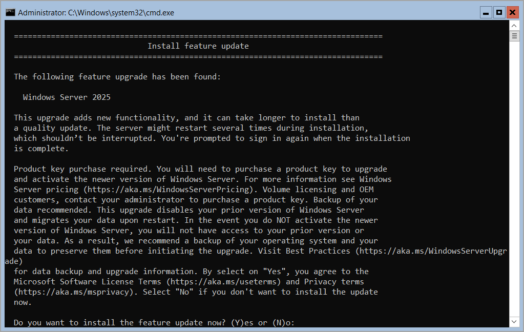

  • Then one level deeper with sub-option 1 (quality updates). Search for and install the feature update.
  • It will trigger the same in-place upgrade process as the WS 2025 feature update will appear. Just hit “Y” to confirm for download and installation. Server will reboot automatically.
