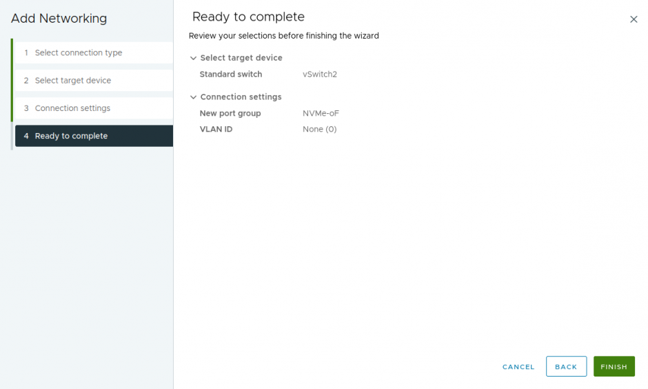

1. Using the VMware ESXi web console, create two standard vSwitches: one for the NVMe-oF/StarWind Heartbeat channel (vSwitch1) and the other one for the Synchronization channel (vSwitch2).
Create vSwitch

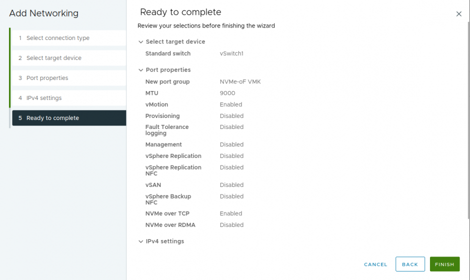

2.  Using the VMware vSphere web console, create a VMKernel port for the NVMe-oF/StarWind Heartbeat channel.
3. Add a Virtual Machine Port Groups on the vSwitch for iSCSI traffic (vSwtich1) and on the vSwitch for Synchronization traffic (vSwitch2).
4. Repeat steps 1-3 for any other links intended for Synchronization and NVMe-oF/Heartbeat traffic on ESXi hosts.

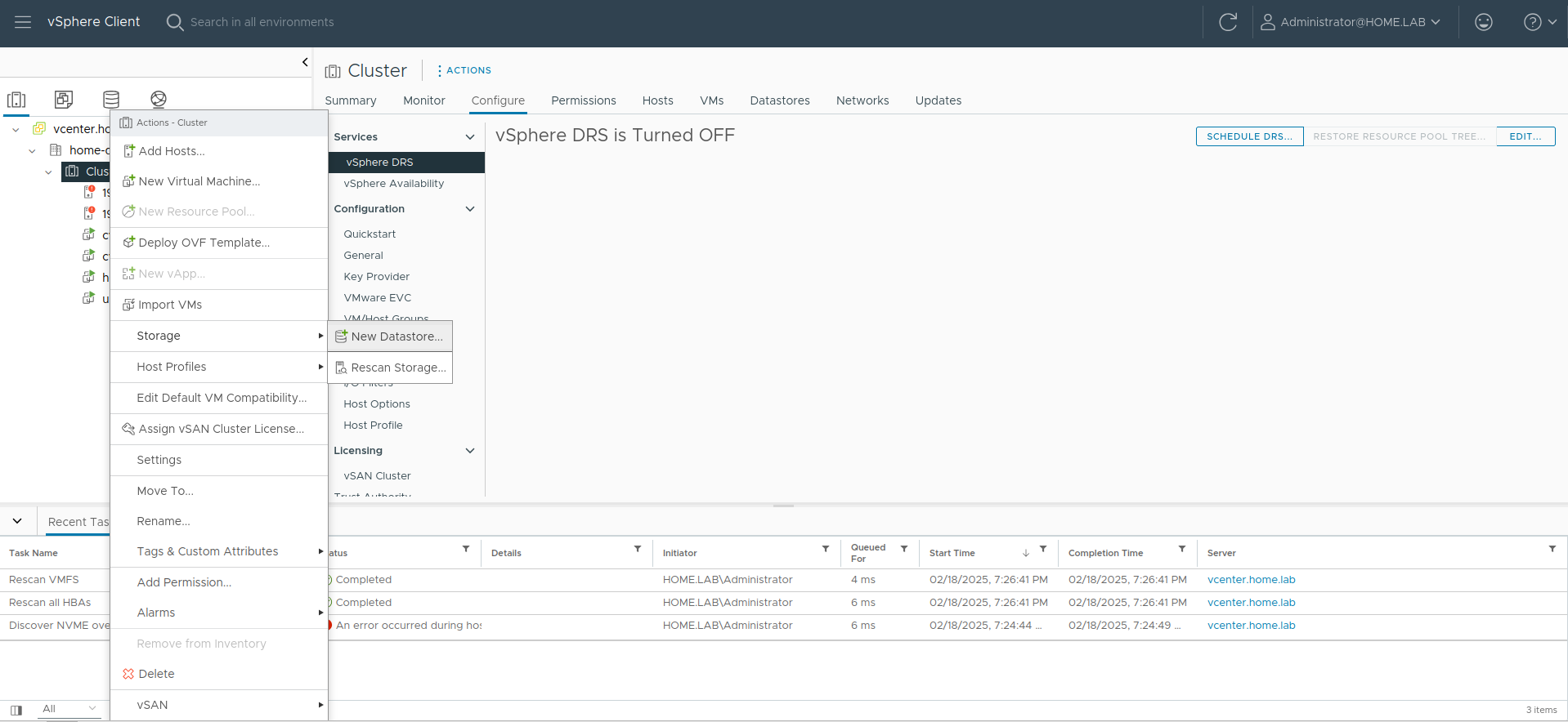

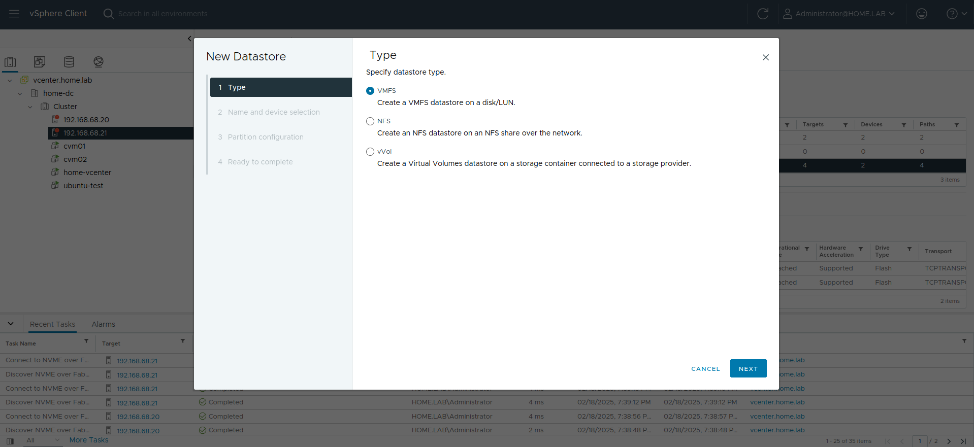

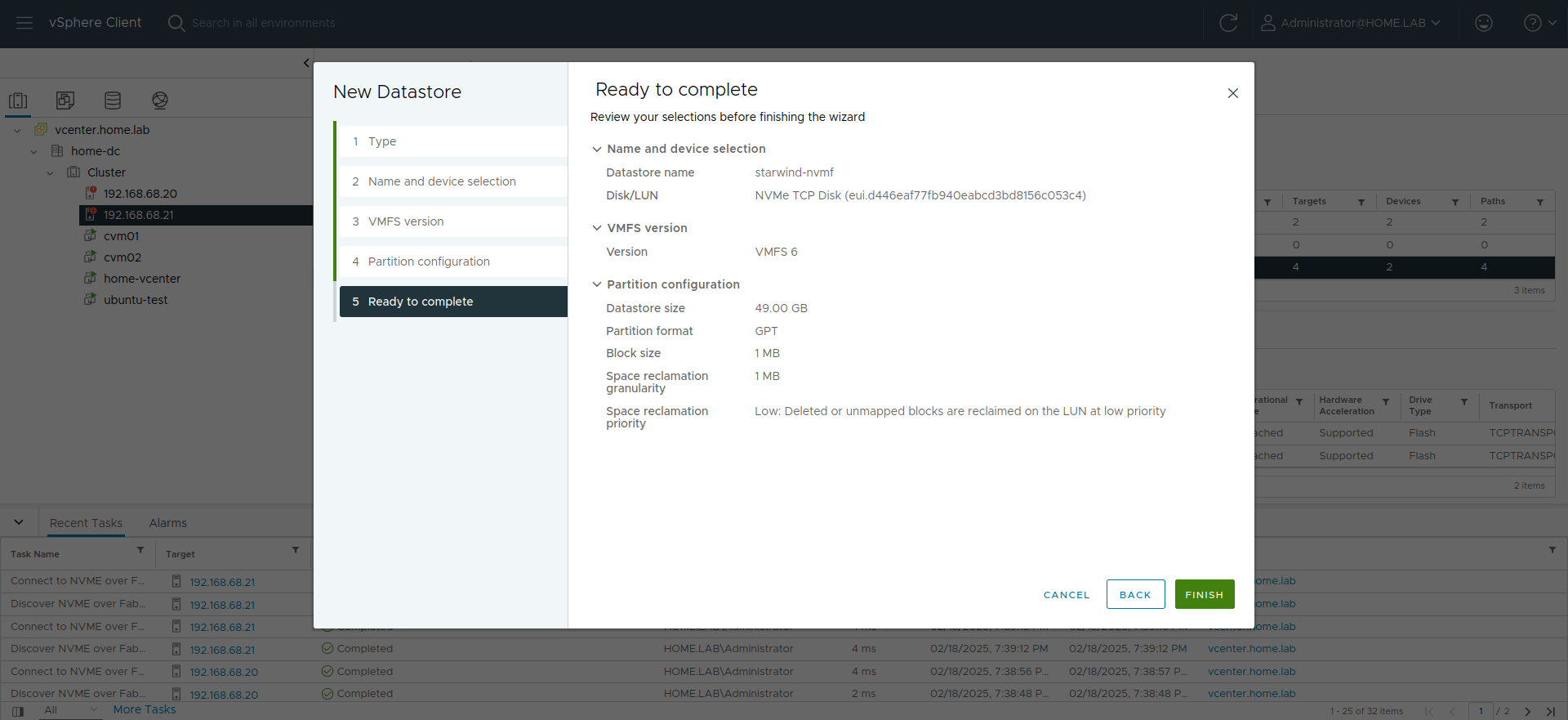

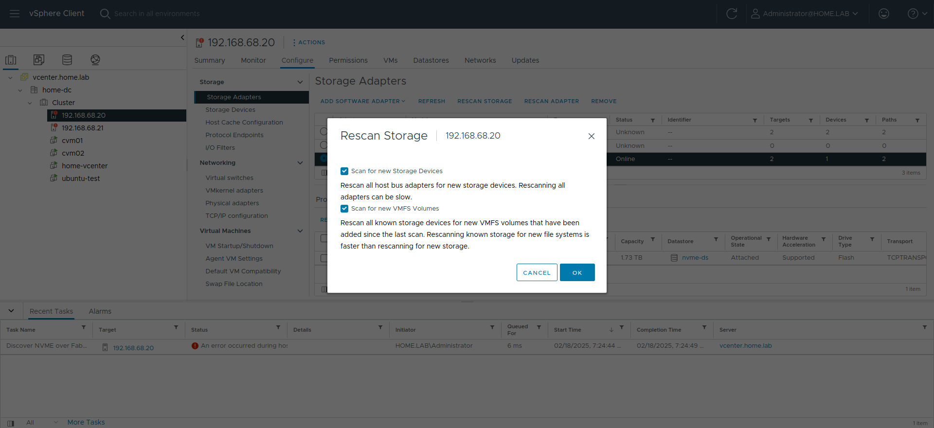

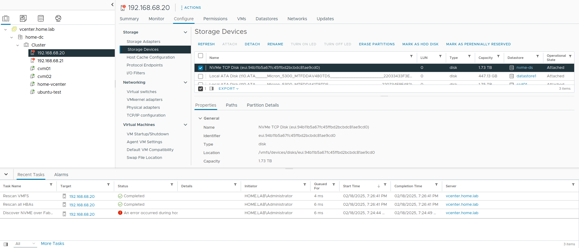

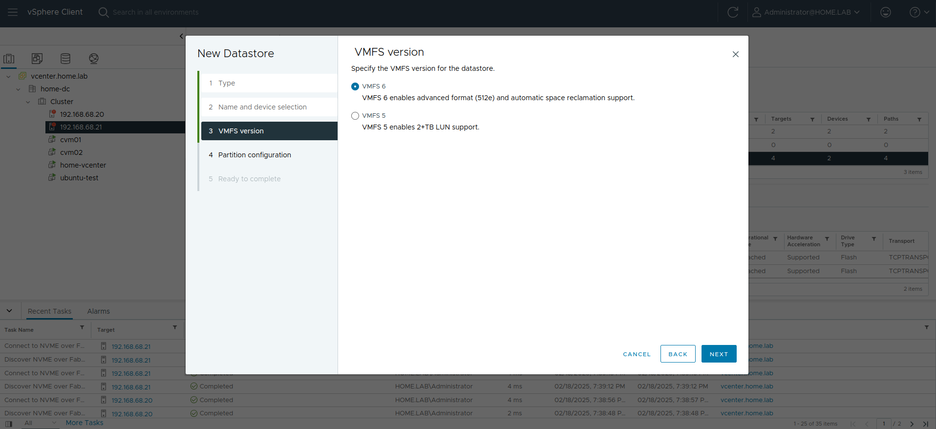

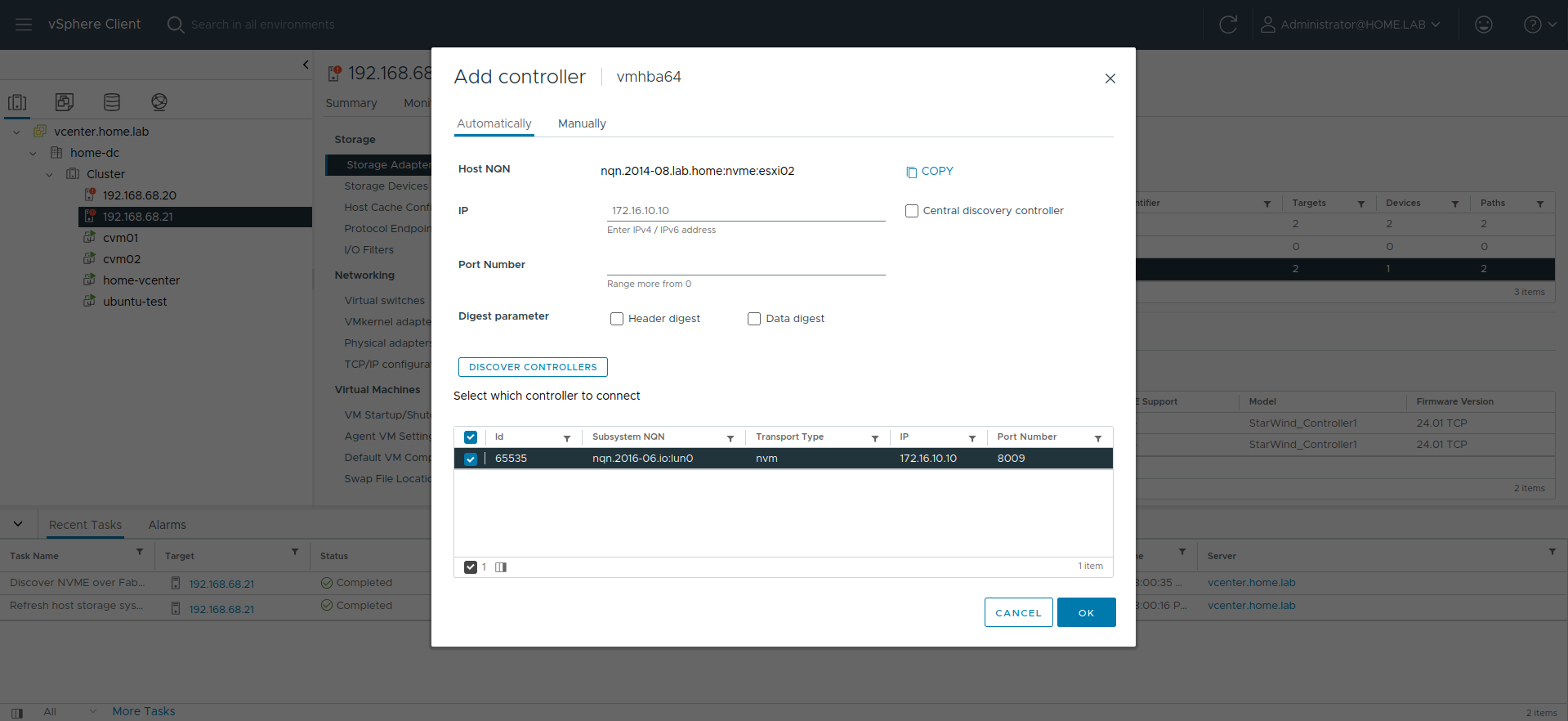

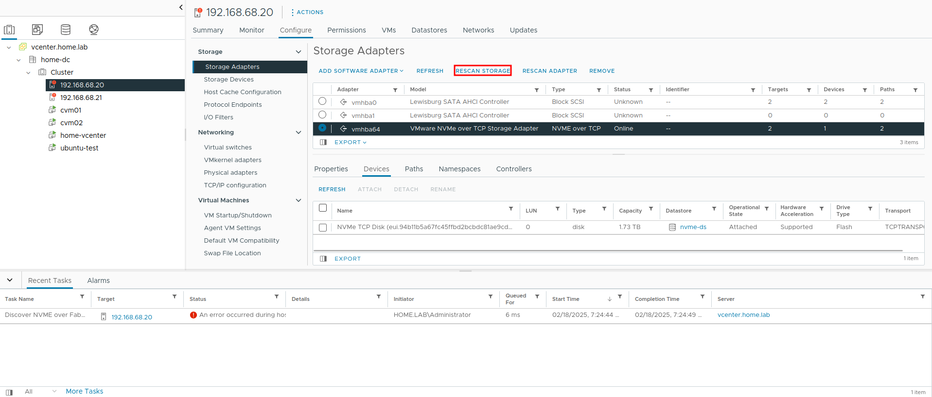

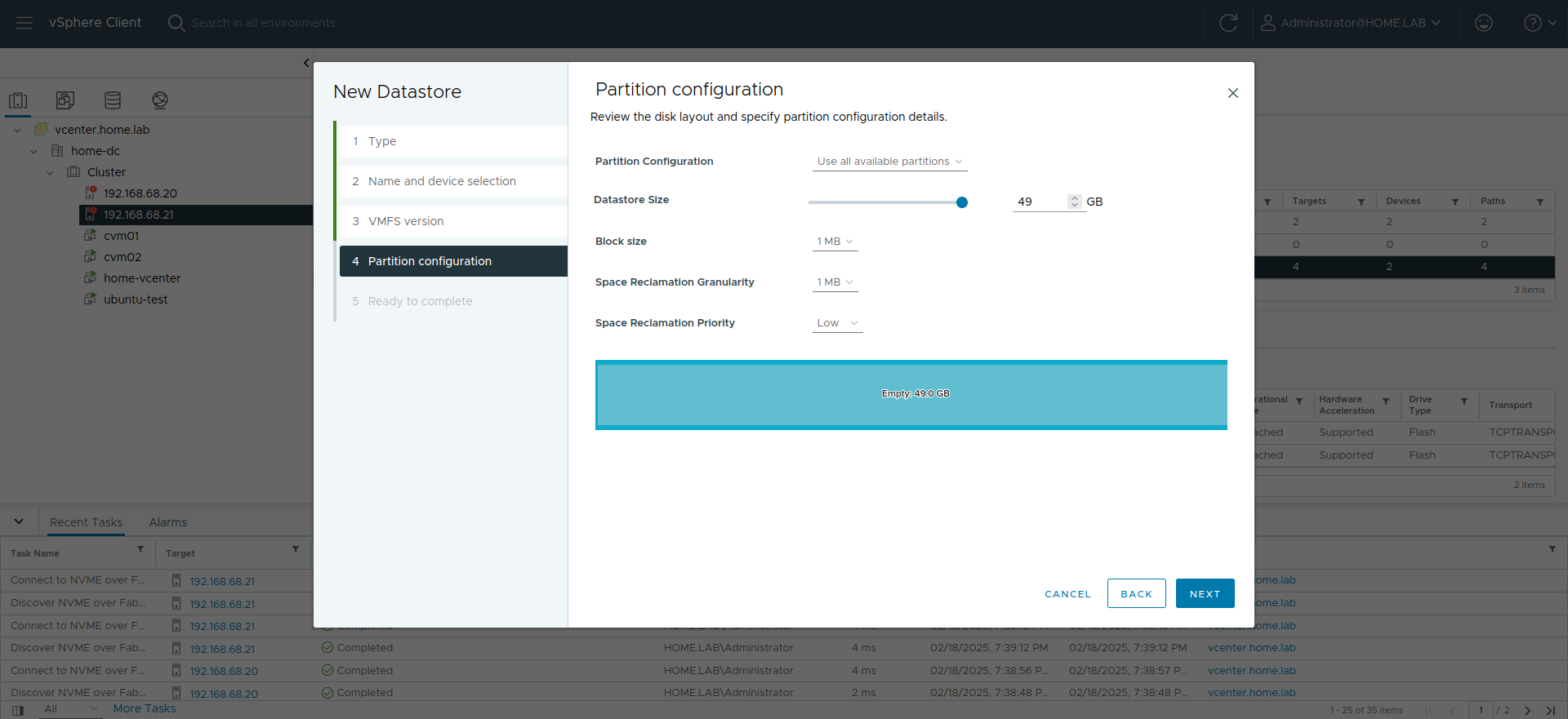

Connecting StarWind LUNs to VMware vSphere servers
1. Log in to VMware vSphere Client.

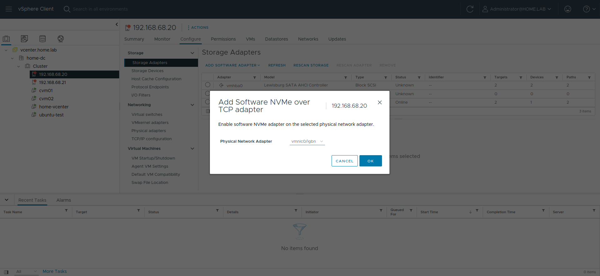

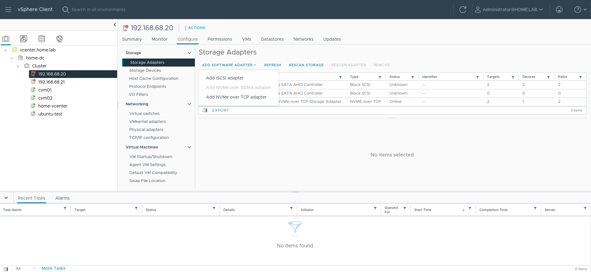

2. Select the ESXi server in the sidebar-menu, then navigate to the “Configure” tab and open the “Storage Adapters” submenu page.
3. Click the “+Add Software Adapter” and choose “Add NVMe over TCP adapter” option to launch the corresponding wizard.
4. Choose NIC for NVMe over TCP connection to StarWind LUN.

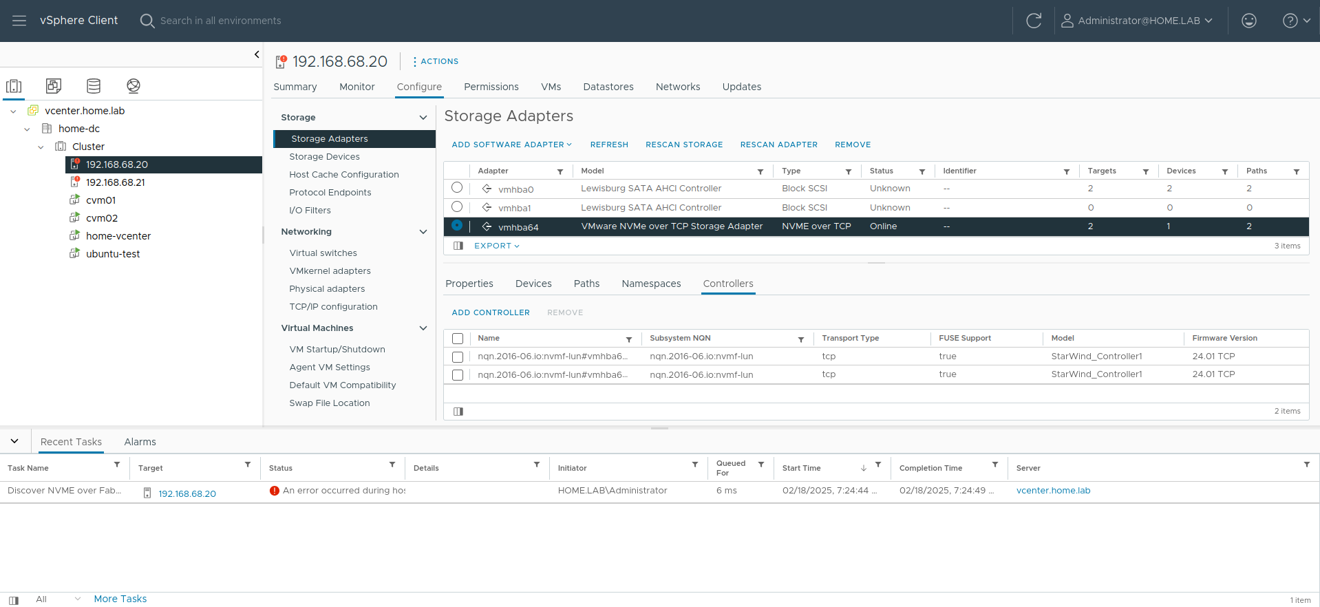

5. Click “Add Controller” on the “Controllers” tab.
Add the IPv4 address of StarWind CVM Data\NVMe-oF network interface to the “Host NQN” and click “Discover Controllers”. Choose controllers with StarWind LUN.
6. Click on the “Rescan” button to discover StarWind virtual disk.
7. Once scanned, the created StarWind LUNs appear on the “Storage Devices” submenu page.
8. Right-click on the ESXi server to open the “Actions” menu, click on “Storage” and click the “New datastore” button.

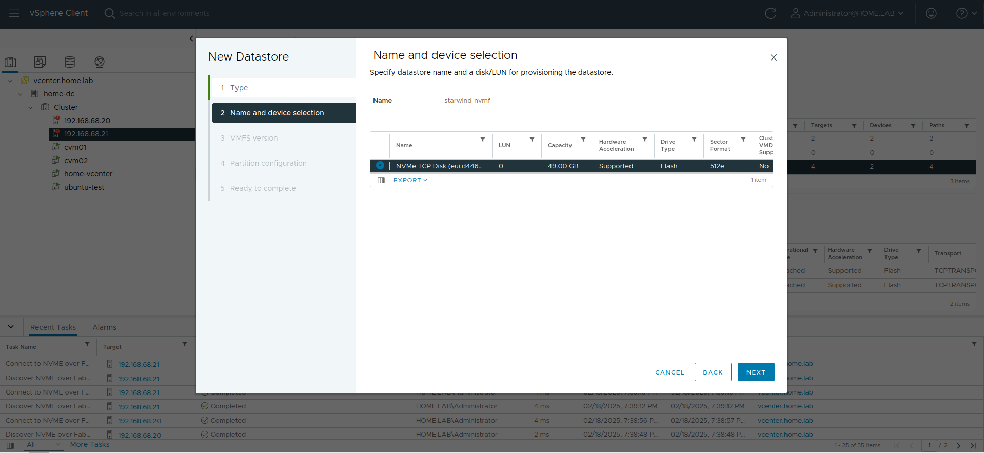

9. The Datastore creation wizard appears. Specify the Datastore type as VMFS.
10. Specify the datastore name. Select the StarWind virtual disk.
11. Specify the VMFS6 version for the datastore.
12. Specify the datastore size using the entire disk capacity.
13. Review the configuration summary and click “Finish” to create the datastore.

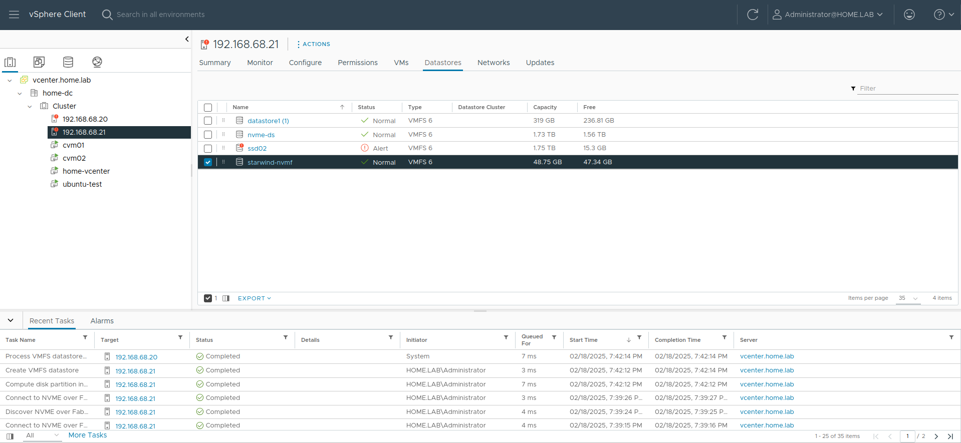

14. Check the StarWind datastore in the Datastores tab.
