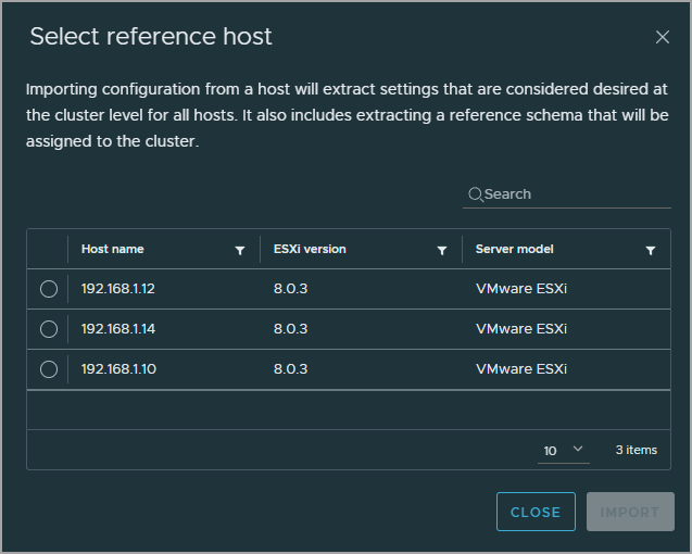

You should then select a reference host from which vSphere will extracts settings.
Selecting reference host window
