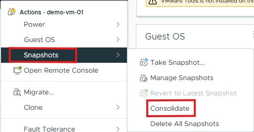

Snapshot menu option
Right-click the VM, go to Snapshots, and check the Consolidate option. If it’s available (not greyed out), the VM has leftover delta files waiting to be merged.

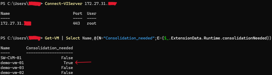

PowerCLI check
In larger environments, use PowerCLI to scan for affected VMs:
Get-VM | Where-Object {$_.ExtensionData.Runtime.ConsolidationNeeded -eq $true}

1. Run Consolidate from vSphere Client
  • Right-click the VM → Snapshots → Consolidate.
  • Confirm the action.
  • Monitor progress in the Recent Tasks pane.
  • When finished, the warning should disappear.
Consolidate option in vSphere Client
Figure 2,3: Consolidate option in vSphere Client

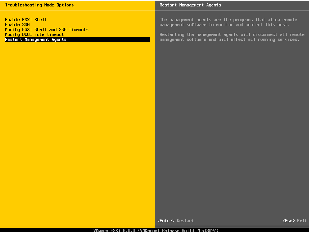

4. Release locked files
  • Make sure no backup jobs are still running for this VM.
  • Check if a backup proxy VM still has the disk mounted; detach it if necessary.
  • If nothing is obvious, restart the management agents on the ESXi host (services.sh restart via SSH or DCUI).
  • After that, try consolidation again.
ESXi DCUI with Restart Management Agents option
Figure 5: ESXi DCUI with Restart Management Agents option
5. Use PowerCLI to force consolidation
  • Run the command:
(Get-VM -Name "VM_Name").ExtensionData.ConsolidateVMDisks()
wp-image-32535
  • Or consolidate all affected VMs:
Get-VM | Where-Object {$_.ExtensionData.Runtime.ConsolidationNeeded} | ForEach-Object {$_.ExtensionData.ConsolidateVMDisks_Task()}
