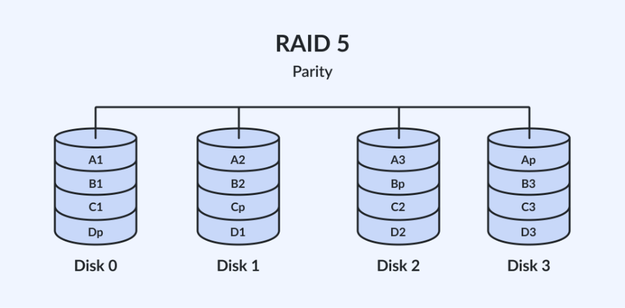

RAID 5: Striping with distributed parity
RAID 5 stripes data across all drives and distributes a single XOR parity block per stripe. The parity role rotates with every stripe, so no single drive becomes a bottleneck. Your OS sees one logical volume with usable capacity equal to n-1 drives, where n is the total drive count.
You need at least 3 drives. With 3, two hold data and one holds parity in a rotating fashion. That’s the smallest array where one drive can fail and you still have enough blocks to reconstruct everything.
RAID 5
Figure 1: RAID 5 layout
When a drive fails, and eventually one will, the array enters degraded mode and keeps running. Reads continue normally. The controller reconstructs missing data on the fly from the surviving blocks. When you insert a replacement, the controller rebuilds by reading every other drive and recomputing. During this rebuild, the array’s degraded and under heavy I/O load. That’s the riskiest period in a RAID 5 array’s lifecycle.
I’ve seen RAID 5 work well on the right hardware and self-destructing on old good SAS 7200 drives. On all-flash or NVMe arrays, rebuild times are measured in hours, not days. The 4x write penalty’s real but tolerable for read-heavy or mixed workloads. You sacrifice one drive’s worth of capacity for parity, which is hard to beat on efficiency. A 3-drive array gives you 66% usable capacity; an 8-drive array gives you 87.5%. For general-purpose file servers and mid-tier databases, that trade-off often makes sense.
The problems start when you scale up with spinning disks. On a 6-drive array with 4 TB HDDs, rebuilding requires reading roughly 20 TB of data. With a 10^14 unrecoverable read error rate (the spec on many enterprise drives from that era) the probability of hitting an unrecoverable error during rebuild is around 16%. That climbs above 30% with 8 TB drives. We’ve learned this the hard way, and theese numbers are why RAID 5’s reputation took a hit on large HDD arrays.
Short version: RAID 5 on SSDs or NVMe in arrays of 3 to 6 drives is a solid, efficient choice. On large HDD arrays, it’s a gamble the math doesn’t support (avoid it like hell).
