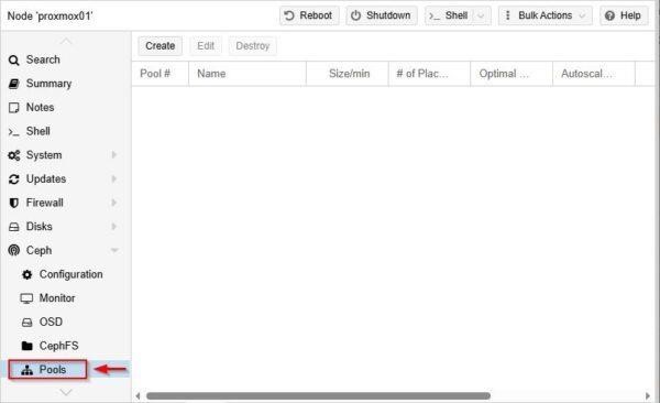

Remove Ceph Pools
Removing Ceph from the configuration is not enough to clean the system. Ceph Pools or OSDs are still in place and to remove them correctly, they shouldn’t be in use.
Select a Proxmox node and navigate to Ceph > Pools. Select the Pools to remove (one at time) and click the Destroy button.
Click Yes to proceed.
All Ceph Pools have been removed successfully.

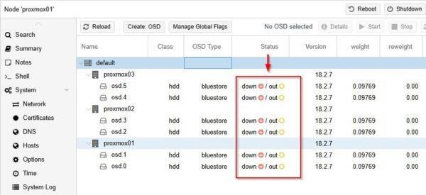

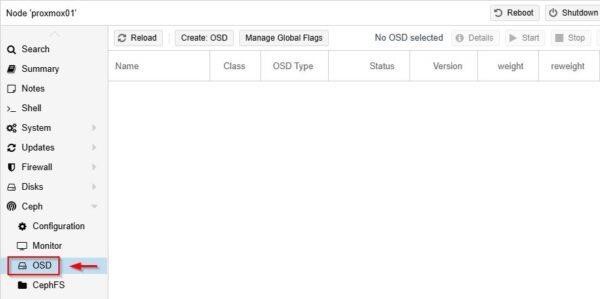

Select a Proxmox node and navigate to Ceph > OSD. Select the OSD to stop and click Stop. The OSD Status will be reported as down.
Make sure all OSDs are in a down Status.

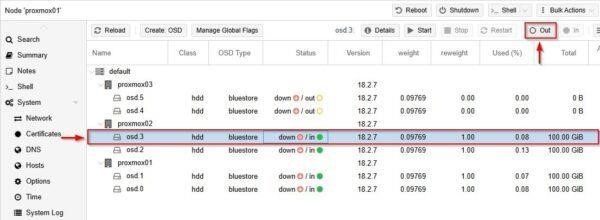

From Ceph > OSD, select the OSD to remove and click Out.
Repeat this step for all configured OSDs.

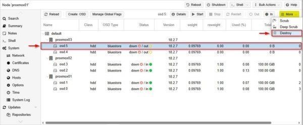

After stopping, the last step involves the removal of the OSDs. Select the OSD to destroy and click Destroy.
Enable the Cleanup Disks option then click Remove.
The selected OSD is being removed.
Repeat these steps for all OSDs to remove.

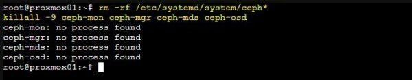

Remove startup files and processes.
# rm -rf /etc/systemd/system/ceph*
# killall -9 ceph-mon ceph-mgr ceph-mds ceph-osd

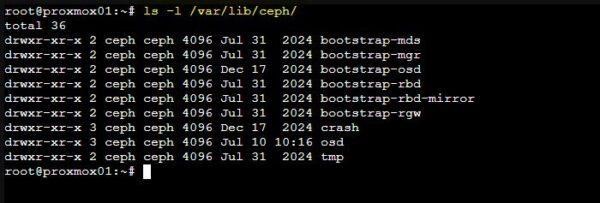

Remove Ceph data directories and check the actual removal.
# rm -rf /var/lib/ceph/mon/
# rm -rf /var/lib/ceph/mgr/
# rm -rf /var/lib/ceph/mds/
# rm -rf /var/lib/ceph/osd/
# ls -l /var/lib/ceph/

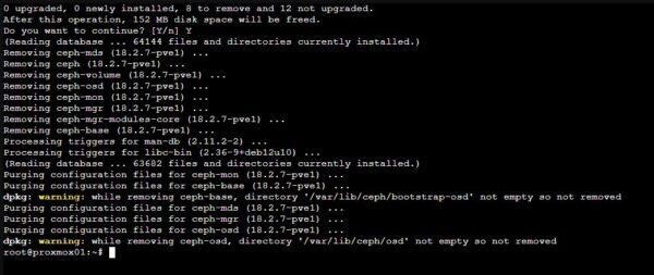

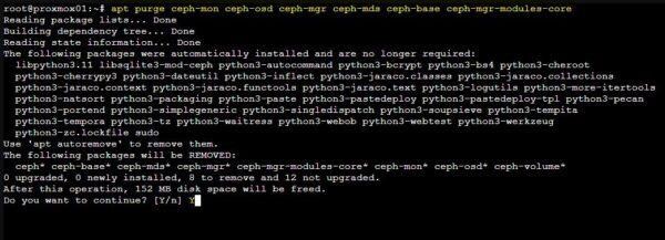

Remove Ceph packages. Type Y then Enter to proceed.
# apt purge ceph-mon ceph-osd ceph-mgr ceph-mds ceph-base ceph-mgr-modules-core
A computer screen shot of white text AI-generated content may be incorrect.
When the removal process is completed, make a note of any directory not deleted by the apt command. You will remove these directories after rebooting the node.
A computer screen with white text AI-generated content may be incorrect.

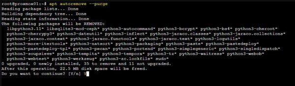

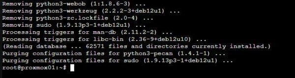

Now run the following command. Type Y then Enter to proceed. # apt autoremove –purge
Packages have been purged from the system.
