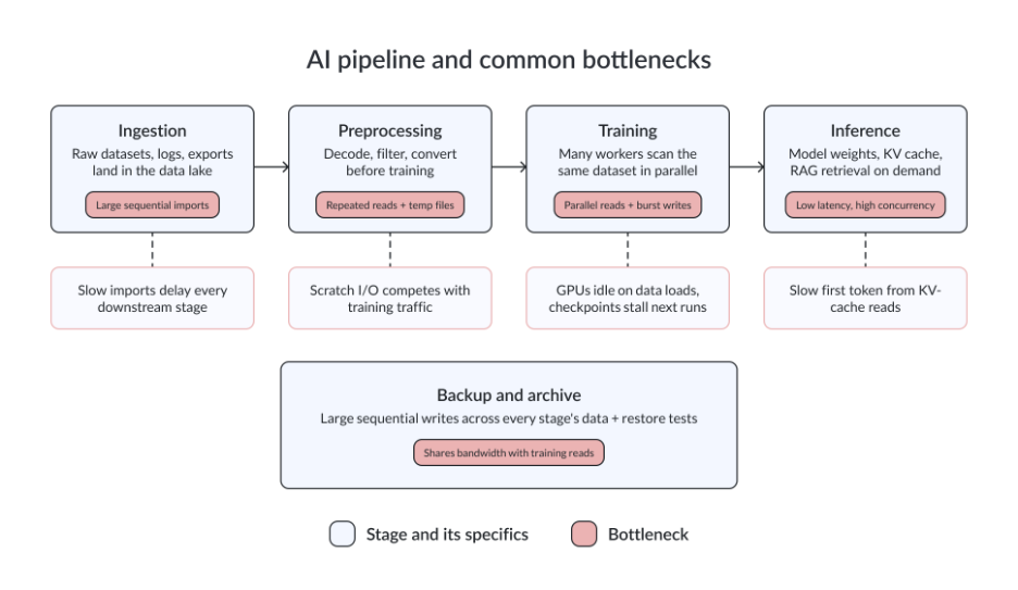

Where bottlenecks appear in the pipeline
Where does storage actually choke? AI workloads span several stages, and each creates a different storage demand.
AI pipeline and common bottlenecks
Figure 1: AI pipeline and common bottlenecks
The larger your pipeline becomes, the more these demands overlap. In many cases – ingestion, training reads, checkpointing, and backup all compete for the same throughput and network bandwidth at once.

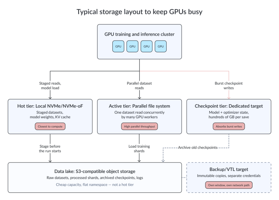

Storage architectures for AI workloads
AI pipelines usually need more than one storage layer. A data lake, a hot training tier, a checkpoint target, and an inference path often have different and sometimes conflicting performance requirements. For a detailed breakdown of storage types designed specifically for AI, see AI storage in 2026: types, benefits, and vendors on the StarWind blog.
Typical storage layout to keep GPUs busy
Figure 2: Typical storage layout to keep GPUs busy
Each architecture solves a different problem, so choosing the right one depends on whether your priority is throughput, latency, scalability, operational simplicity, or cost.
The most common architectural mistake is trying to use one storage platform for every stage of the pipeline. For example, platforms such as WekaFS, VAST Data, and DataCore Nexus are designed specifically for HPC-style access patterns. NVMe storage via NVMe-oF serves the hot tier, whether that means rapid model loading during inference or handling burst checkpoint writes during training.
For edge AI deployments and read-heavy workloads in particular, NVMe-oF makes shared flash accessible across local nodes without requiring a central SAN. StarWind VSAN and DataCore SANsymphony both support this transport layer for compact edge clusters running local inference.
