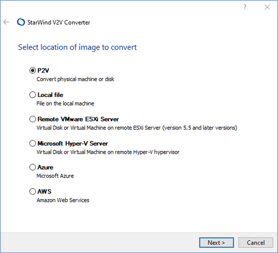

  1. Select P2V as location of image to convert.

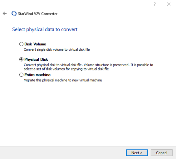

  2. To convert Physical Diskfrom the Windows machine, choose the necessary option and click Next to continue.

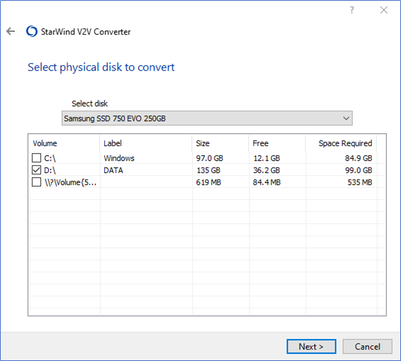

  3. Choose the physical disk to convert and click Next to continue.

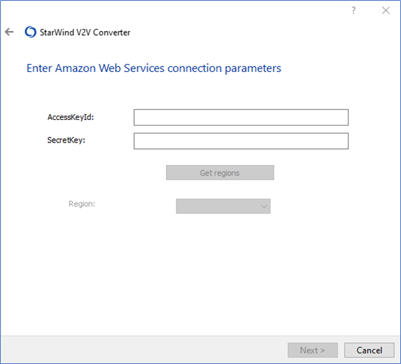

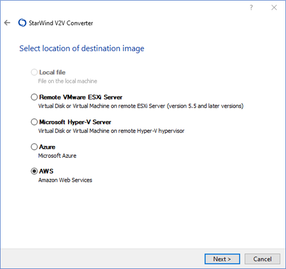

  4. Select AWS as the location of destination image.
  5. Enter the AccessKeyId and SecretKey. Click Get regions. Select the destination region.

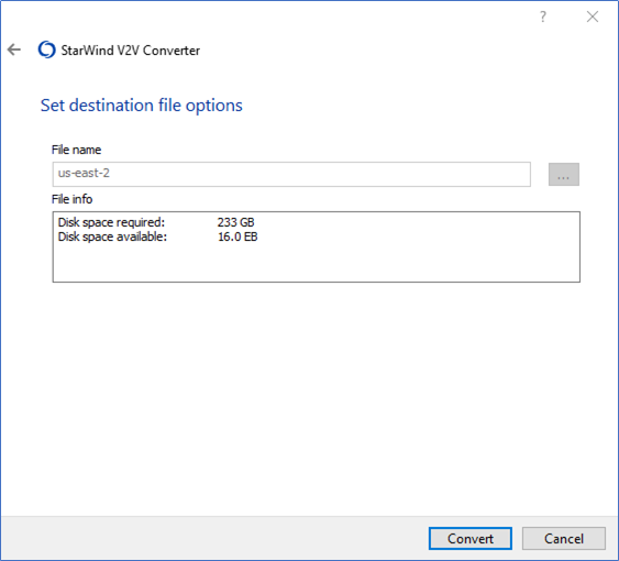

  6. Check the settings of the new virtual machine and modify them if needed. Press Convert.

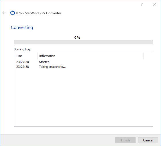

  7. Wait until the conversion process is over and press Finish to complete the wizard or Convert another image if there are more images or virtual machines to convert.
