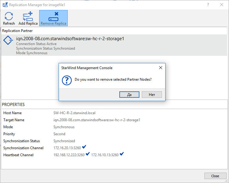

To remove a replica:
1. Launch Replication manager.
2. Select the replica and click Remove Replica.
3. Confirm the deletion of the replica.
